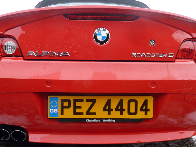

It should work fine on the front of an E46 - my Roadster S has a curve on the front plate carrier and, before fitting the (plastic) front plate, I left it overnight, face-down, with the edges on wooden blocks and a weight in the centre.
This created a gentle curve in the plate allowing it to conform better to the shape of the plate holder and avoided any tendency for the ends to try and pull away from the holder while the trim tape reached full strength (takes about 24 hours IIRC) - trim tape is so strong that I doubt if it would have been an issue but it cost me nothing to curve the plate so thought I'd do it...

Yes, the rear of the RS has these as well - I still wanted a screwless look though, so I attached a plastic plate holder using plastic screws and then mounted the plate onto that using adhesive tape. You can't see them but I added a couple of soft pads to the rear of the plate holder (one at each edge) to act as a cushion if the ends vibrated and contacted the paint
